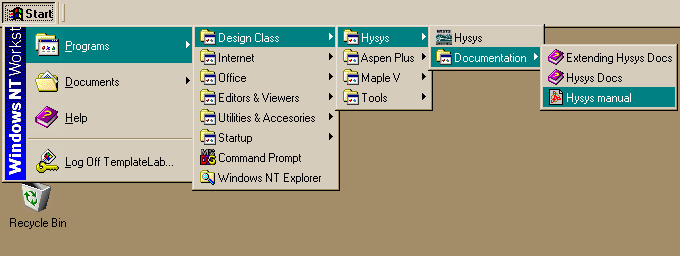

The other environment, and the one you actually have to deal with first when you start a case, is the basis environment. The basis environment is the place that you define the thermodynamic package you wish to use (Peng-Robinson, Margules, etc.), the components that will be used in your simulation and any reactions that may occur. If dealing with a Petrochemical application, there is also an oil environment that may be reached only from the basis environment.
There are two files that HYSYS reads whenever you start HYSYS. One of these is the Preferences File, the other is the workbook format file. The preferences file tells HYSYS many important things like which units you want to use, where to look first for your stored files etc. You can have multiple preference files saved (or you can just build up various unit sets, etc., in one file you alter upon need), but the one that is loaded upon startup is the file named hysys.prf in the directory from which HYSYS is started. If you launch HYSYS from your start menu, your user's profile has been configured with Y:\Hysys as the start directory (note that if you are not in a design class group, you won't have a Y drive, because the purpose of theY drive is to save group work). If you look at the contents of that directory you will see, in addition to some other stuff, that I have placed a hysys.prf file in there for you. That is the file that must be overwritten if you want to make changes to your default preferences (though changes are automatically saved to the preference file when you save your simulation, so overwriting should not often be necessary).
You may have noticed the other file I put there, hysys.wrk. That file is responsible for the appearance of your workbook. The workbook shows you the contents of every stream in your process and the connections of every unit (if you really wanted to you could make your entire simulation using the Workbook and never even look at the PFD). Without the hysys.wrk file, unless the file has undergone changes to its workbook which got saved with that particular case, the default is for the workbook to only show two pages: Streams and Unit Ops. Now, if you've done any reading of the manuals or working of the tutorials you were propably expecting four pages: Material Sreams, Compositions, Energy Streams, and Unit Ops. The Workbook is much harder to work with without the extra info these pages provide. The file I provided restores these other pages, but again it is only automatically loaded if the Start Menu was used to launch HYSYS.
Why am I telling you all this? Because there are a number of cases where you will not be able to use the start menu to do what you want. If you start a file by double clicking it (your simulations should all be stored underY:\Hysys\Cases), without a hysys.prf file present, HYSYS will use the default file located on the NTserver calledHartsook. It is not configured for you and you cannot save changes to it. HYSYS will also fall back on that file if you do not have a Y drive. Moreover, any time you want to run one of HYSYS' or my example files, because of a failure of HYSYS to handle links or networks well, the only way you'll be able to see Hartsook (where all the sample files are located), is to double-click on one of your own files (causing HYSYS to "start in" a directory on Hartsook), then turn right around and close that file. Then, you may Open the example file. Note that HYSYS' examples are located in \\Hartsook\Hysys\SAMPLES, not in CASES as the manuals say, and that my examples are located in \\Hartsook\Hysys\SAMP403.
What ever you are trying to do, if you used one of the above methods, HYSYS will not open with the correct Preference File. The first thing you should do once HYSYS opens is open Preferences under the Tools Menu. Then press Load Preference Set... . Load Y:\Hysys\Hysys.prf. At that point you may or may not need to import your workbook format. Push the Workbook button
, on the toolbar to find out. If you do need to, then choose Import under the Workbook Menu and import the file hysys.wrk under Y:\Hysys.
Note: Should you somehow create a Hysys.prf file under your cases directory, DELETE or move it, as you will not be able to get to the example files on Hartsook with it there. An automatic way of telling if your preference file is based on the one I started you with or if it is HYSYS' default is the color of the background. HYSYS' preference file makes the background the same brown color as your desktop. My preference file uses a deep purple as the background color.​
